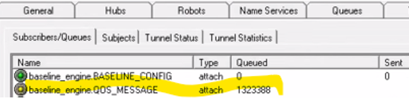

Hub queue is showing queued but never sent

The probe does not really use attach and get queues. The Baseline_engine processes the QOS directly.

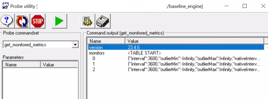

In this image from the probe utility, you can see there are rules configured. This allows the queue to process correctly.

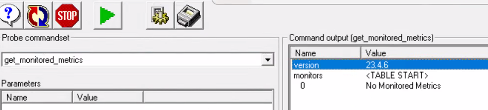

In this server, there are no rules so the QOS has no where to do because there are no rules configured.
