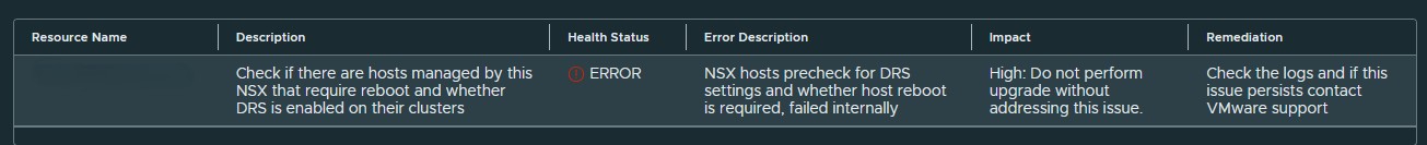

During the NSX upgrade process, the upgrade precheck workflow pauses and displays the following warning message: "Check if there are hosts managed by this NSX that require a reboot and whether DRS is enabled on their clusters".

The NSX Upgrade Coordinator incorrectly flags a pending host reboot requirement due to a stale state or synchronization issue within the NSX Manager cluster, causing the precheck to fail even when the underlying ESXi hosts do not actually require a reboot.
