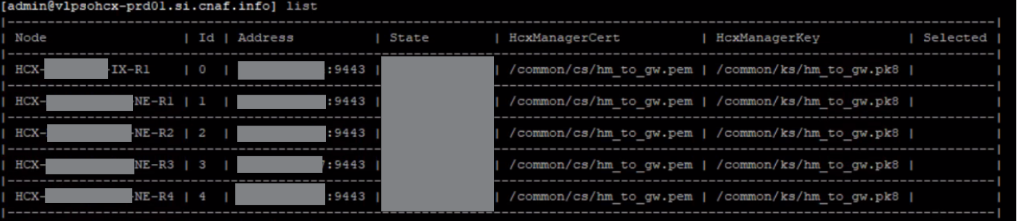

  •  Executing the ccli list command from the HCX Manager displays the fleet appliances (IX/NE) in a "Disconnected" state.
  • This indicates a management communication failure between the HCX Manager and the IX/NE appliances.
