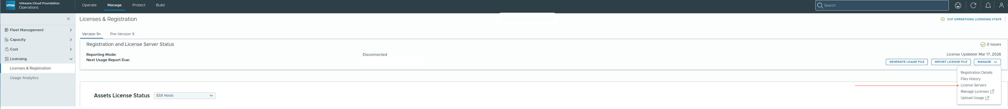

  3. Log in to the VCF Operations User Interface (UI).
  4. Navigate to Manage > Licensing > Licenses & Registration > Manage > License Servers.
  5. Review the specific License Server details pane and confirm that the reported operational status displays as Healthy and Connected.
