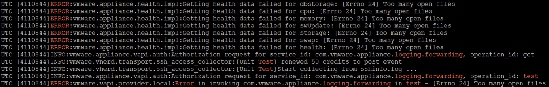

applmgmt.log @ /var/log/vmware/applmgmt/ in the vCenter reports the below:

    • Fails with OSError: [Errno 24] Too many open files when the appliance has exhausted available file descriptors, causing vCenter to return an HTTP 500 error.
