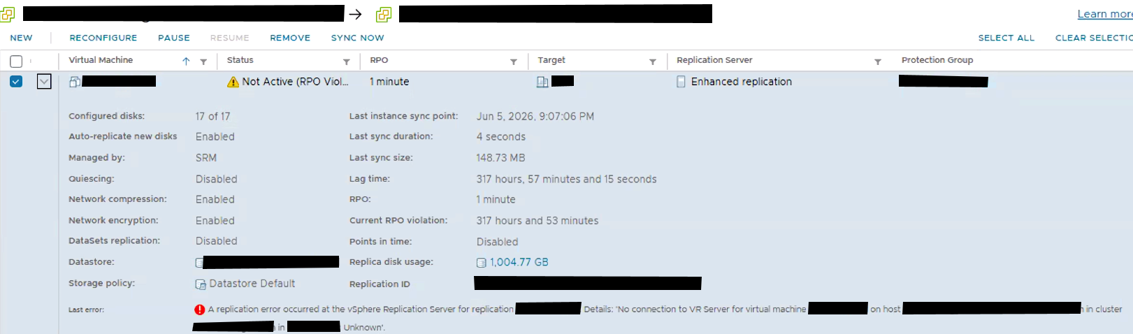

Replication status for virtual machines remains in a Not Active (RPO violation) state for VMs replicating to the appliance where the certificate was changed. The reverse replication is working without issues.
The vSphere Replication UI or site pairing displays the error: A replication error occurred at the vSphere Replication Server for replication. Details: 'No connection to VR Server: Unknown'.
Synchronization fails even though network connectivity (ping/telnet) between sites is confirmed.

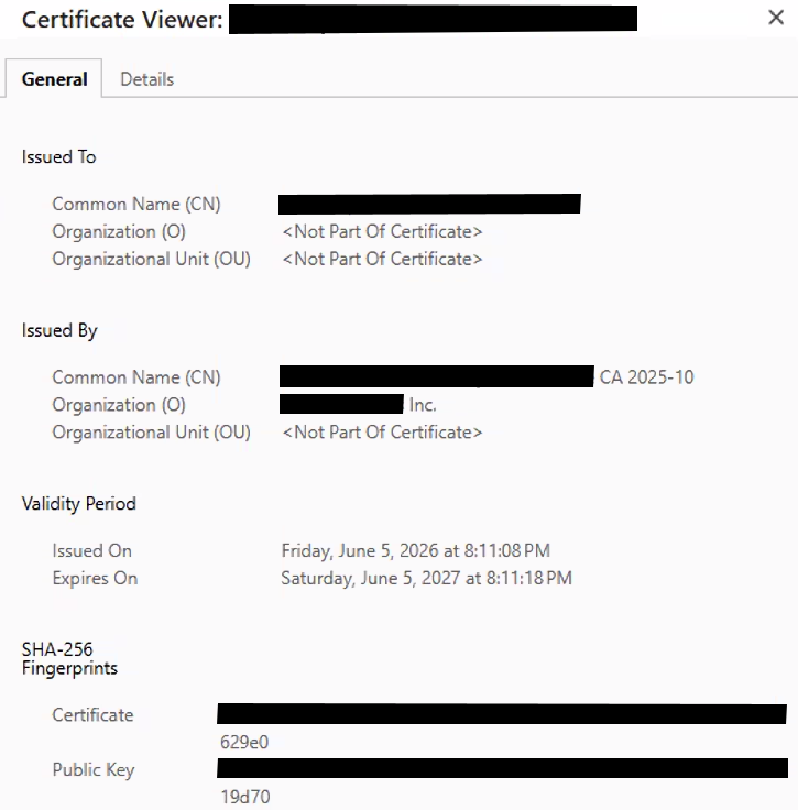

The correct renewed certificate can be viewed using the below command:
openssl s_client -connect VRappliance_IP/FQDN:8043 2>/dev/null | openssl x509 -noout -fingerprint -sha256
