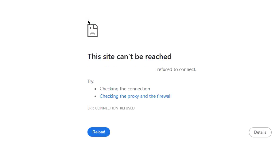

  • Loading the Appliance Configurator on port 8443 (https://<vIDM_FQDN>:8443) fails with the error "This site can't be reached".
  • Executing ss -tulpn | grep 8443 indicates that port 8443 is not listening.
