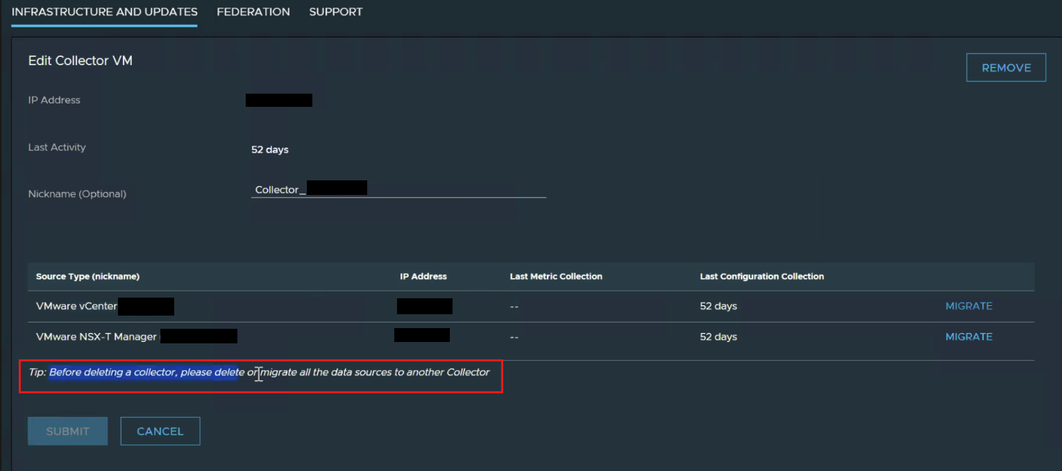

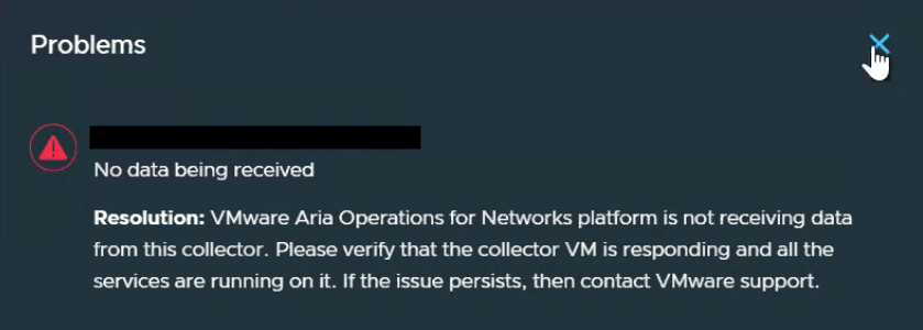

Aria Operations for Networks (AON). One of the Collector VMs is not working and appears disconnected from the Platform. When attempting to edit the configuration, the UI prompts to delete the collector option. Initial checks indicate all internal services are running on the Collector VM, but communication with the Platform node fails.
Aria Operations for Networks 6.14.x
The primary cause of this behavior is a time synchronization (NTP) drift between the Platform VM and the Collector VM, which silently breaks the certificate-based secure communication tunnels preventing data transfer.

  3. Action: Compare the outputs. The time must match almost exactly. If the Collector's time is off, verify that your NTP servers are reachable and configured correctly. You may need to reconfigure the NTP settings if they are failing to sync.
