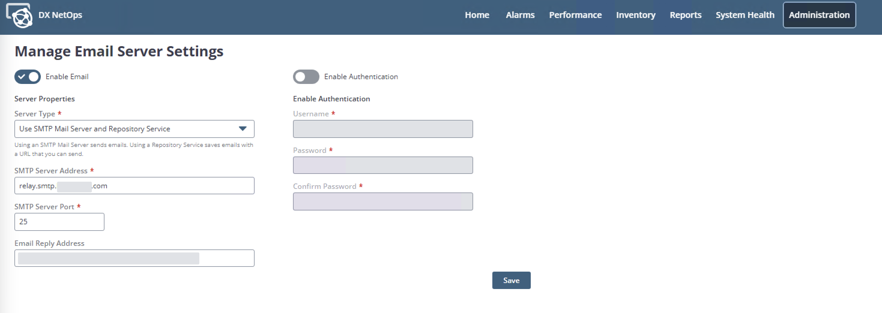

There is confusion when setting up emails with NFA because while the SMTP Server address is configured in the NetOps Portal Manage Email Server Settings page and synced down to NFA to be used like the below:

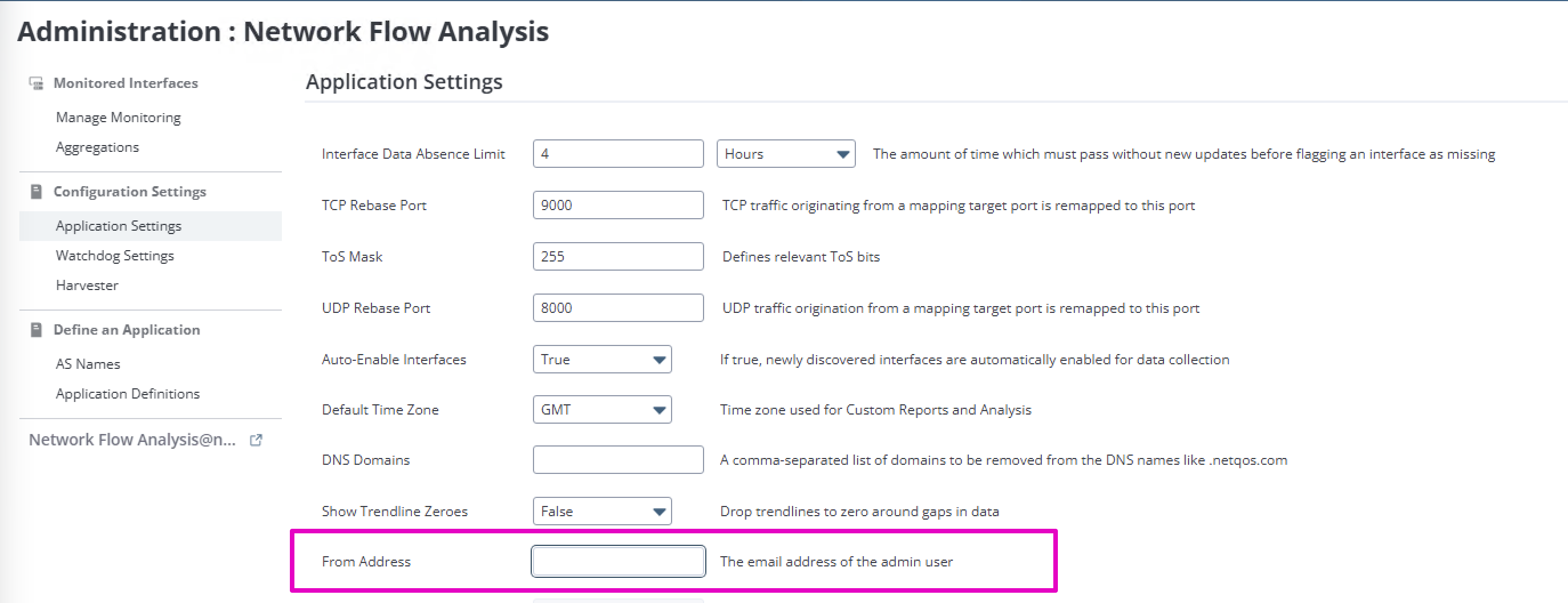

The emails which are sent from NFA are sent will use the, "From Address", from a different location. Instead the , "From Address", NFA uses is set up in the NetOps Portal > Administration > Data Sources > Network Flow Analysis (NFA) console > Application Settings page.
This issue typically occurs because the, "From Address", set within that NFA Console, Application Settings page, has not been configured yet or has the incorrect email address set. If no value is set in the NFA Application Settings page, NFA will default, "no_reply@<servername>.com".
To ensure NFA emails are delivered from the email address you expect:
1. Log in with administrative privileges to the NetOps Portal > Administration > Data Sources > Network Flow Analysis (NFA) console.
2. Navigate to  Application Settings on the left hand side pane and look for, "From Address":
3. Populate the correct value, and click Save.
