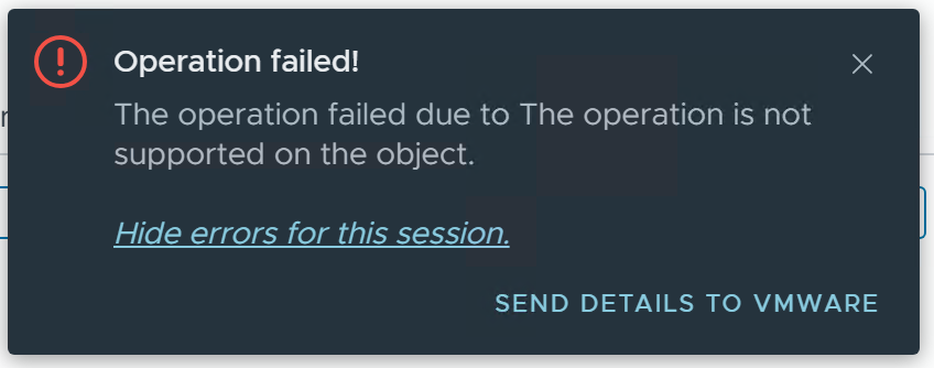

  • When performing OVF deployment using the vCenter server UI console, the task may fails with an error 'The operation failed due to the operation is not supported on the object'
  • Deployment of OVF using ovftools also fails with the error 'The operation is not supported on the object' .

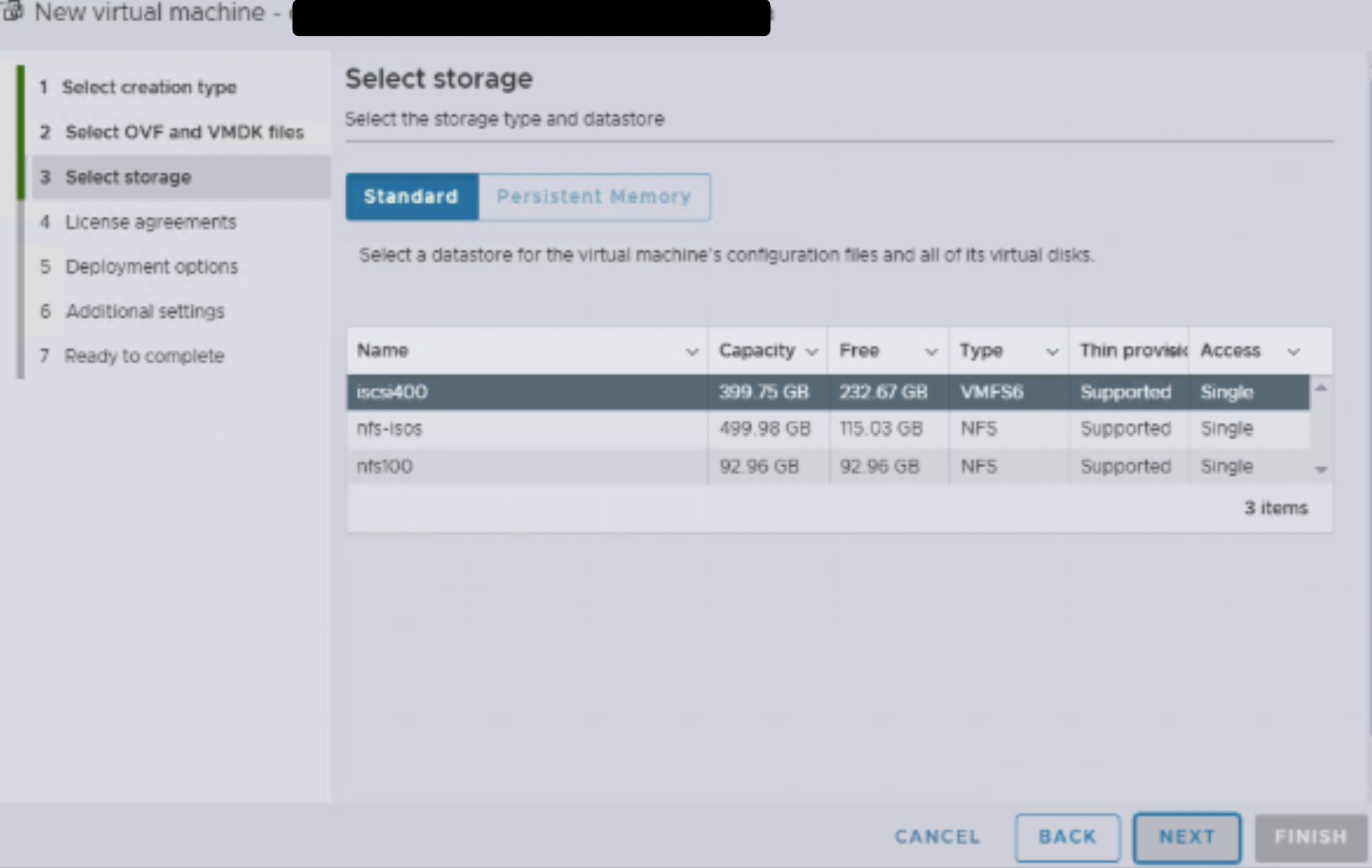

  • The deployment task initiating from ESXI host UI console will not allow to proceed further when selecting the storage as part of deployment task.
