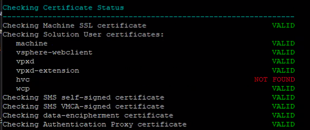

  • Checking the certificate status using vCert utility shows the hvc Solutions User certificate as "NOT FOUND":

The hvc solution user is missing from the SSO domain, and the hvc VMware Endpoint Certificate Store (VECS) entry is missing its certificate. Because the store is empty, lsdoctor cannot read a certificate to bind to the directory, causing the recreation to fail.
