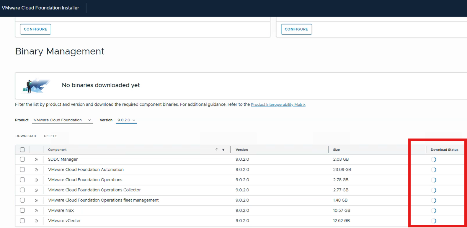

VMware Cloud Foundation (VCF) 9.0.2 binary upload fails:
Symptoms include:
  • The VCF installer UI displays the "Download status" as below in the Binary Management section.
  • The VCF download tool command line outputs: "Error: Failed to upload all the metadata"

  • The /opt/vmware/vcf/lcm/vcf-download/log/vdt.log file contains the following exception: Caused by: com.vmware.vcf.rest.api.runtime.ApiException: java.io.FileNotFoundException: /nfs/vmware/vcf/nfs-mount/PROD/COMP/SDDC_MANAGER_VCF/Compatibility/VmwareCompatibilityData.json (No such file or directory)
VMware Cloud Foundation 9.0.2
The Compatibility directory and the required VmwareCompatibilityData.json file are missing from the NFS mount path (/nfs/vmware/vcf/nfs-mount/PROD/COMP/SDDC_MANAGER_VCF/).
Please follow the below steps to resolve the issue
     1.Create the missing directory path on the NFS mount: mkdir -p /nfs/vmware/vcf/nfs-mount/PROD/COMP/SDDC_MANAGER_VCF/Compatibility
     2.From a Windows workstation/Linux Machine with internet access, manually download the VmwareCompatibilityData.json file.
Command from Windows Workstation:
  • curl.exe --request GET --url "https://vvs.broadcom.com/v1/products/bundles/type/vcf-lcm-v2-bundle?format=json" --header "x-vmw-esp-clientid: vcf-lcm" > "C:\temp\VmwareCompatibilityData.json"
Command from Linux machine:
  • curl --request GET --url 'https://vvs.broadcom.com/v1/products/bundles/type/vcf-lcm-v2-bundle?format=json' --header 'x-vmw-esp-clientid: vcf-lcm' > /nfs/vmware/vcf/nfs-mount/PROD/COMP/SDDC_MANAGER_VCF/compatibility/VmwareCompatibilityData.json
     3.Transfer the downloaded VmwareCompatibilityData.json file to the  VCF environment and place it in the newly created directory: /nfs/vmware/vcf/nfs-mount/PROD/COMP/SDDC_MANAGER_VCF/Compatibility/
     4.Set the correct ownership and permissions on the directory and file so the LCM services can access it: chown -R vcf_lcm:vcf /nfs/vmware/vcf/nfs-mount/PROD/COMP/SDDC_MANAGER_VCF/Compatibility/
     5.Rerun the binary validation from the VCF Installer UI. The Binary Management section should now display a success status.
