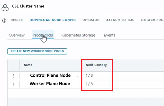

• When attempting to create a Tanzu Kubernetes Grid (TKG) cluster from the VMware Cloud Director Tenant Portal, the cluster is only partially created.
  For example, if you configure the cluster with 3 worker nodes, it may complete with only 1 node deployed (1/3) and display no errors in the user interface.

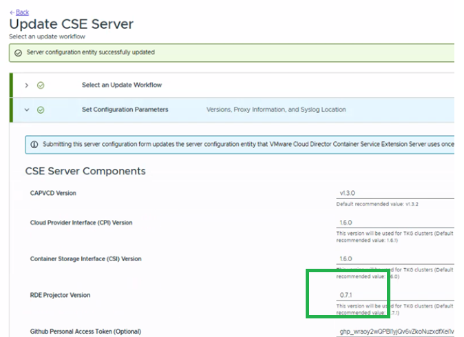

   • Log in to the VMware Cloud Director Provider Portal.
   •Navigate to Kubernetes Container Cluster.
   •Select the option to update the CSE Server.
   •Change the RDE Project Version to 0.7.1.
   •Click Save to apply the changes.
   •Re-deploy the CSE Cluster.
Note: The cluster will deploy successfully, but it may take 20 to 30 minutes for the updated cluster status to fully reflect in the UI.
