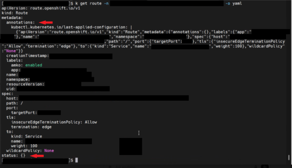

  • The GSLB Service is not created for the configured OpenShift Route.
  • The Route is not updated with the required VS UUID, Controller UUID annotations, and status information after AKO synchronization.
  • The screenshot below shows the Route without the required VS UUID/Controller UUID annotations and an empty status (status: {}).

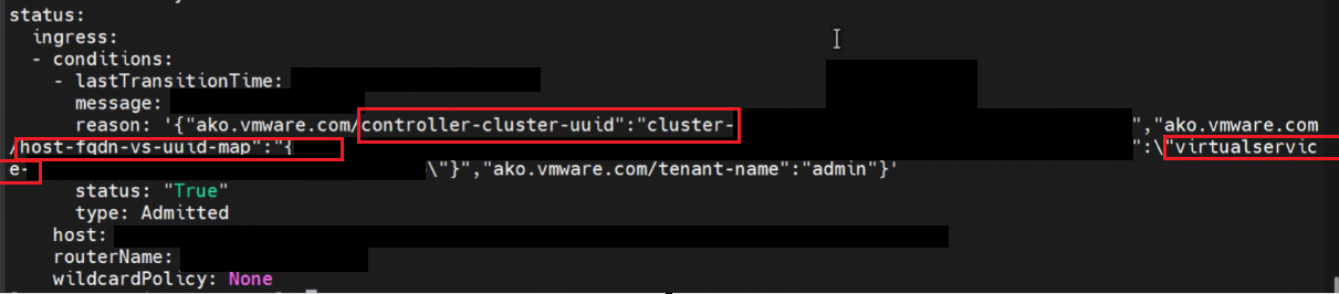

  • The screenshot below shows an example of a Route with the expected annotations and populated status.

  • When AKO is configured in Dedicated SNI mode, it skips updating the OpenShift Route with the required VS UUID, Controller UUID annotations, and status if the Route is configured with insecureEdgeTerminationPolicy: Allow. As a result, AMKO skips processing the Route, and the GSLB Service is not created.
  • To verify the AKO deployment mode (Dedicated VS mode), run:
    kubectl get configmap avi-k8s-config -n avi-system -o yaml
    shardVSSize: DEDICATED
  • AKO log:
    kubectl logs -n avi-system <ako-pod-name>
    status/route_status.go:47 Skipping update of parent VS annotation since the route : <route-name> has InsecureEdgeTerminationAllow set to true
  • AMKO log
    kubectl logs -n avi-system <amko-pod-name>
    msg: skipping route because either VS UUID or controller UUID missing from annotations
