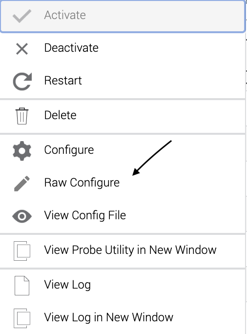

1. Login in UIM Admin Console
2. Search for OI_Connector probe

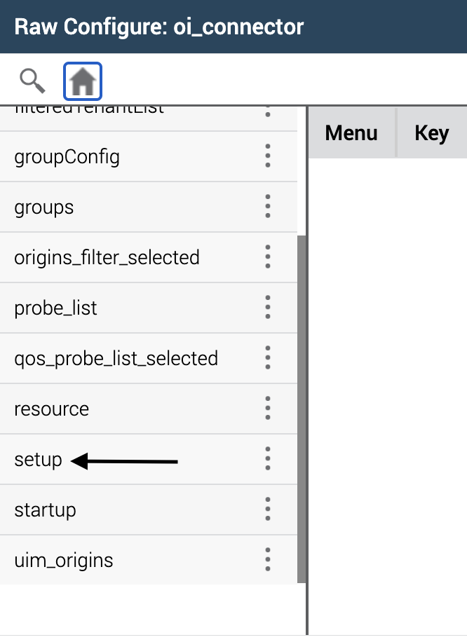

3. Click on the three dots, then "Raw Configure"
4. Search and click in "Setup" at the left menu:

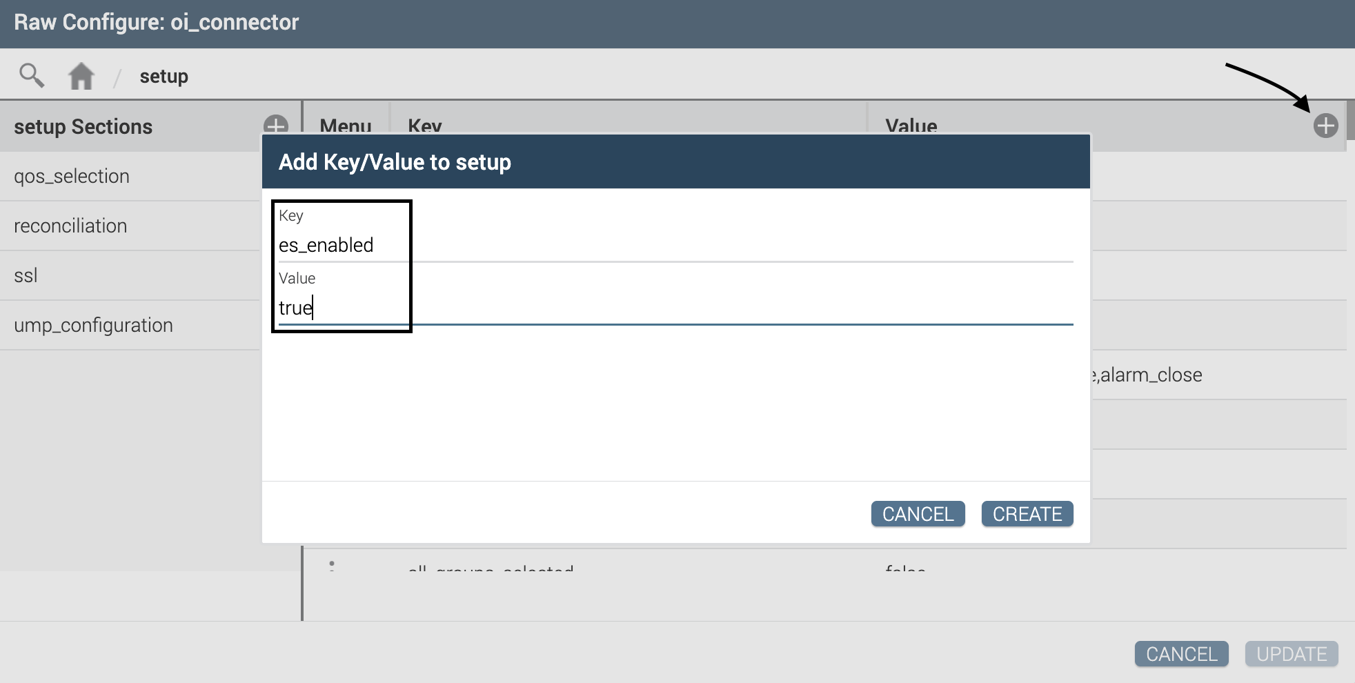

5. Now add es_enabled as a new variable as the screenshot, then click in "Create" and after that click in "Update"
6. After saving the raw config change, you need to restart the oi_connector probe for the parameter to take effect.
