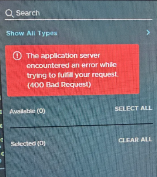

While accessing Security Explorer / Visualization page, group filters fail to populate and UI displays: “The application server encountered an error while trying to fulfill your request. (400 Bad Request)”
Article ID: 444711
VMware vDefend Firewall with Advanced Threat Prevention VMware vDefend Firewall
Users encounter NullPointerException errors when accessing visualization batch auto-completion APIs in SSP, specifically when processing segObj* group/classification filters. The error occurs due to missing display names in SSP group config table, causing "Comparable.compareTo" to fail when attempting to compare null objects during group filtering operations.
This issue typically manifests when:
  • Accessing Security Group visualization features
  • Using batch auto-completion APIs for group filtering
  • Processing classification filters in the UI
  • Performing operations that require group display name comparisons
