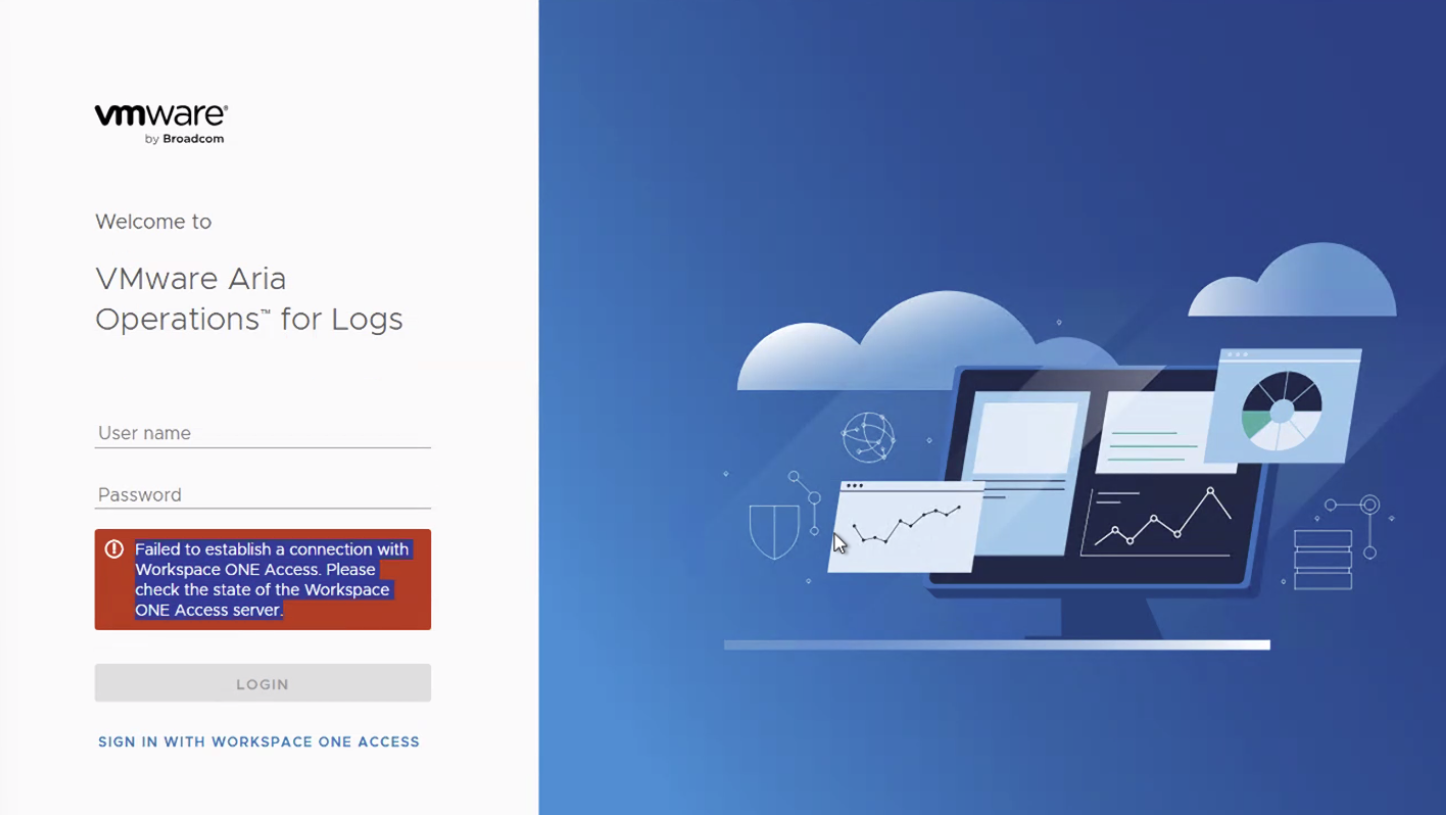

When attempting to sign in to the VMware Aria Operations for Logs portal using the "Sign in with Workspace ONE Access" option, the login fails with the following UI error:
Failed to establish a connection with Workspace ONE Access. Please check the state of the Workspace ONE Access server.
