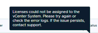

Licenses could not be assigned to the vCenter System. Please try again or check the error logs. If the issue persists, contact support.

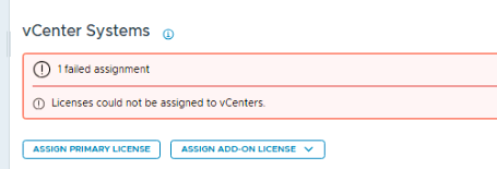

Failed to apply License to vCenter server.
  • Errors observed in the VCF Operations UI:
