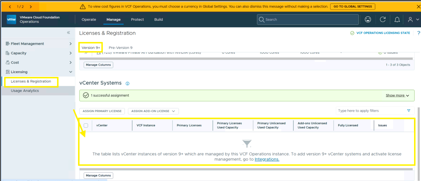

Unable to license vCenter server post upgrading VCF operations to 9.1, vCenter does not list in VCF Ops > manage > Licensing > Lincese & Registration > vCenter systems
Article ID: 444477
VCF Operations
After upgrading to VMware Cloud Foundation (VCF) Operations 9.1, vCenter systems may not appear in the Licensing management UI.
Attempts to register or sync licenses result in an internal server error.
This issue typically occurs when stale vSAN license entries exist within the vCenter LDAP database.
In the VCF Ops UI when recreating the adapter, we see transient error message
Internal Server Error
Logs state the following
VCF Ops can't license or list the vCenter "Could not retrieve vcenter info"
