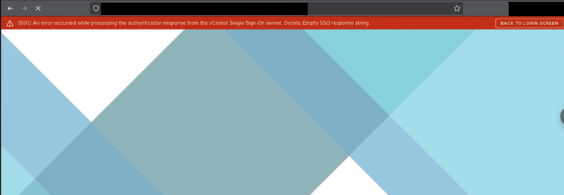

The primary product affected is VMware vCenter Server, specifically within the Single Sign-On (SSO) and Security Token Service (STS) components.
You may observe the following symptoms:
[500] An error occurred while processing the authentication response from the vCenter Single Sign on server. Details: Empty SSO response string.
administrator@vsphere.local) fail or time out despite valid credentials.The var/log/vmware/sso/vmware-identity-sts-perf.log indicates severe latency establishing LDAP connections:
