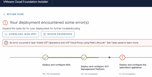

During the VMware Cloud Foundation (VCF) 9.1 deployment, the process fails at the "Install VCF Operations and VCF Cloud Proxy using Fleet Lifecycle" stage.
The VCF Installer UI indicates that only 5/14 steps are completed for the "Deploy and configure the operations appliance" workflow, and a "Status polling timed out" error is observed for the failed task.
When reviewing the logs, specifically using the command: kubectl -n vcf-sddc-lcm logs vcf-sddc-build-service-sddcbuild-##########-#####, following error is observed: "Specified NTP server is specified incorrect."
