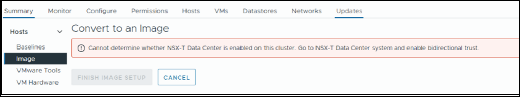

When attempting to convert a vSphere cluster's lifecycle management method from baselines to a single image using vSphere Lifecycle Manager (vLCM), the operation fails.
The vSphere Client displays the following error message:     Cannot determine whether NSX-T Data Center is enabled on this cluster. Go to NSX-T Data Center system and enable bidirectional trust.
