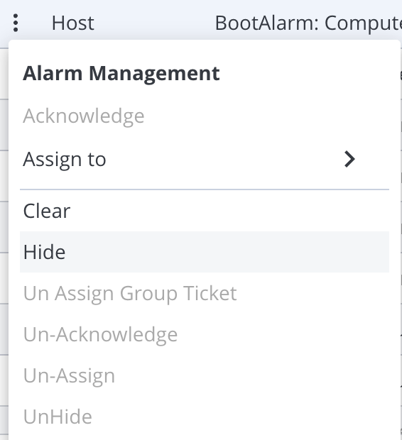

To clear a single alarm:
   *Right-click the alarm row, or click the action menu (three dots) at the end of the row.
   *Select "Clear".

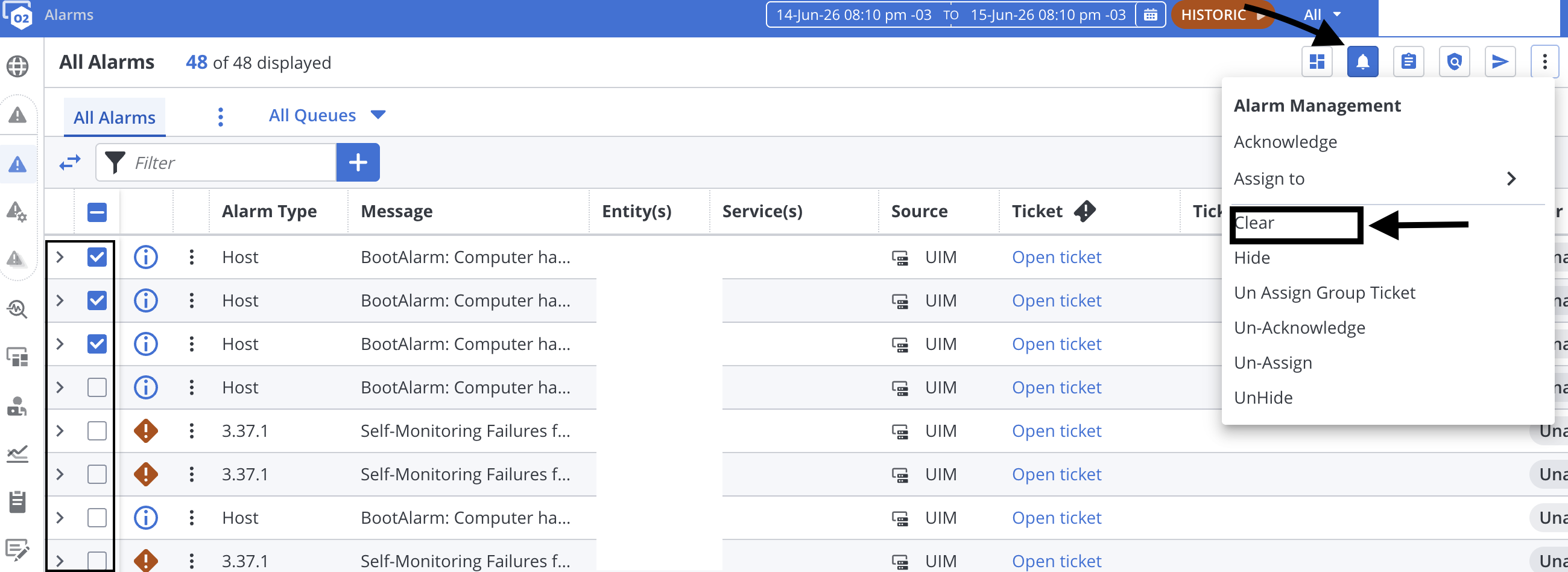

To clear multiple alarms (Bulk Clear)
   *Check the checkboxes next to the target alarms.
   *At the top toolbar of the alarm table, click the action button and select "Clear Alarms".
