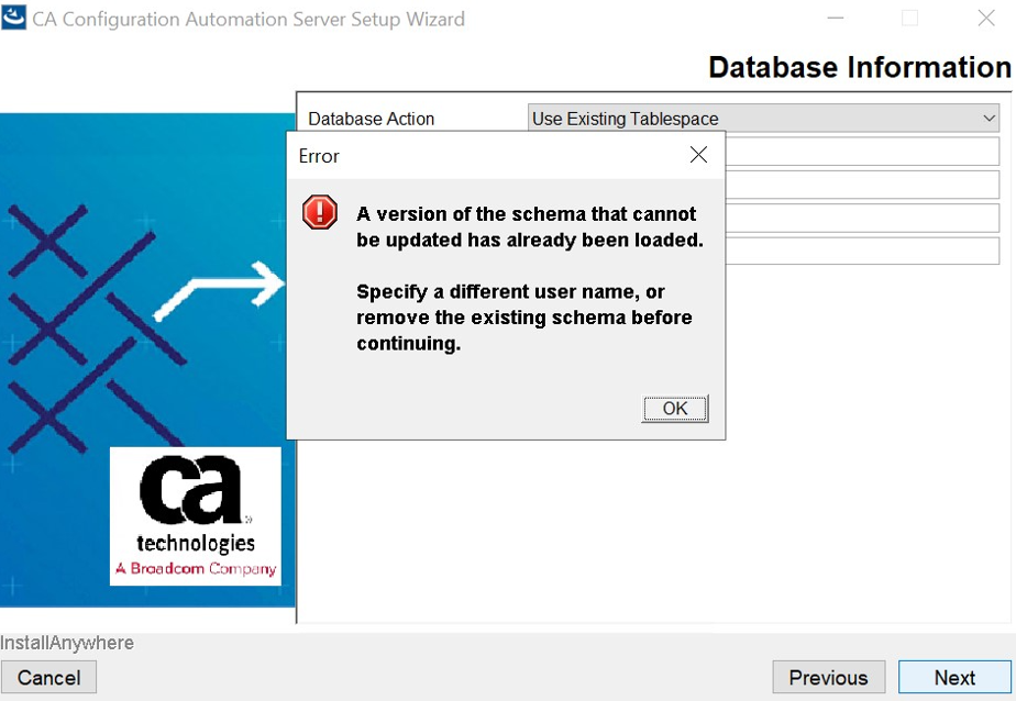

During reinstallation of Configuration automation 12.9 following error appears :
A version of the schema that cannot be updated has already been loaded.
Specify a different user name, or remove the existing schema before continuing.

Schema name CCA_12_9_0_123* appears in the result of query. This is preventing the reinstallation of Configuration Automation 12.9
  1. Execute following SQL Query
    delete from mdb_schema_information where FileType='driver' and filename like 'CCA_12_9_0_123_upgrade_%'
  2. Try again the reinstallation of configuration automation 12.9.0.54
  3. Then apply the patch (12.9 build 123 or higher version).
