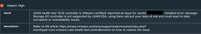

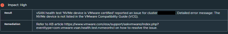

  • The upgrade is blocked by strict vSAN health checks enforced by VCF Fleet Manager during the REMEDIATE phase, triggered by underlying NVMe device and SCSI controller warnings.
  • Host remediation is prevented by Fleet Manager if vSAN health alarms are active to protect cluster data integrity.
  • Silence the active vSAN health alarms (NVMe devices and SCSI controllers) in the vSphere Client to bypass the Fleet Manager health check.
