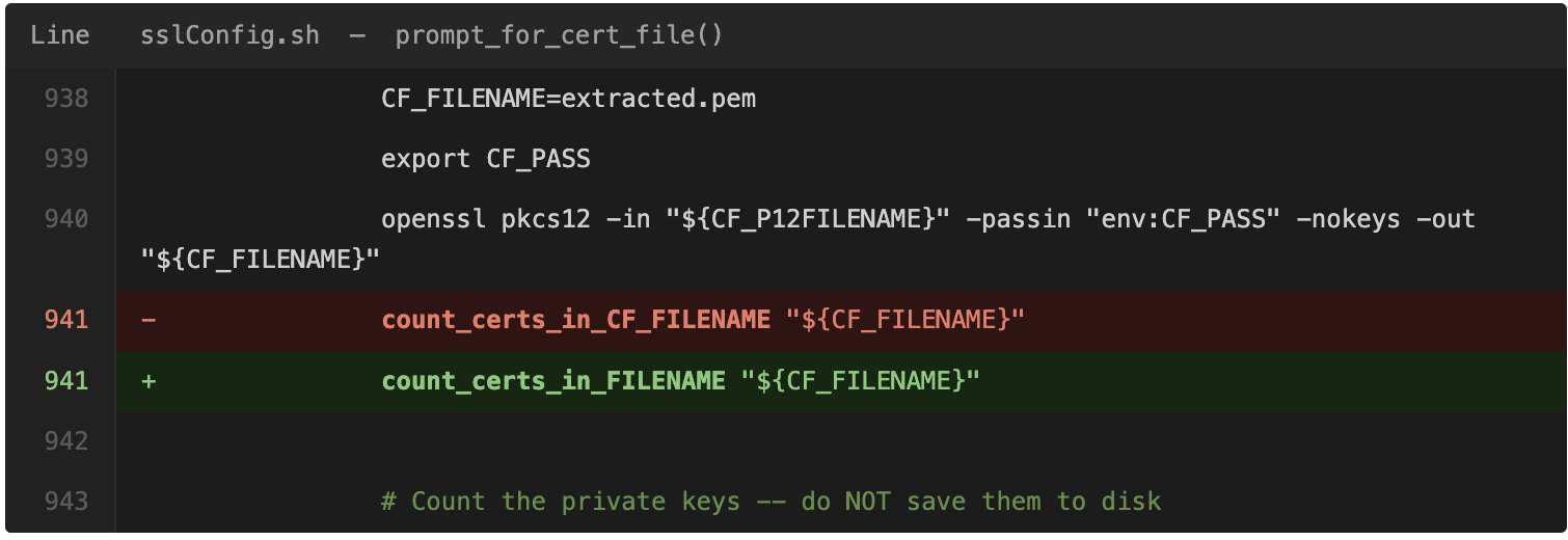

There is a hardcoded typo in the /opt/IMDataAggregator/scripts/sslConfig.sh script. On line 941, the script incorrectly attempts to call a function named count_certs_in_CF_FILENAME. However, the correct function name defined elsewhere in the script is count_certs_in_FILENAME.

vi +941 /opt/IMDataAggregator/scripts/sslConfig.sh
Navigate to line 941 and change the line to match the after row in the diff below, then save with :wq.

941: count_certs_in_CF_FILENAME "${CF_FILENAME}"# grep CF_FILENAME: (no output) # grep FILENAME: 4 matching lines
