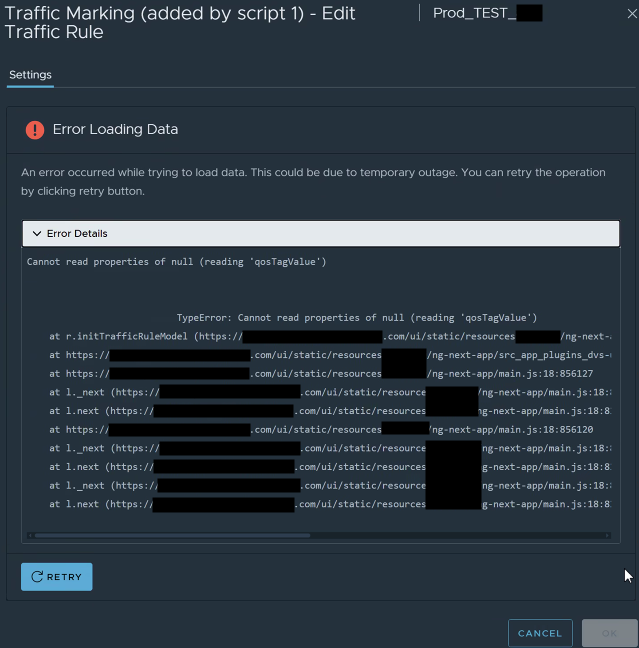

When attempting to edit the Traffic Marking properties of an existing Distributed Virtual Switch (VDS) Portgroup via the vSphere Client UI, the following error is displayed:
TypeError: Cannot read properties of null (reading 'qosTagValue')
Additionally, packet captures on the ESXi host confirm that QoS tags are not being applied to the ingress traffic flow.
