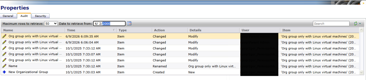

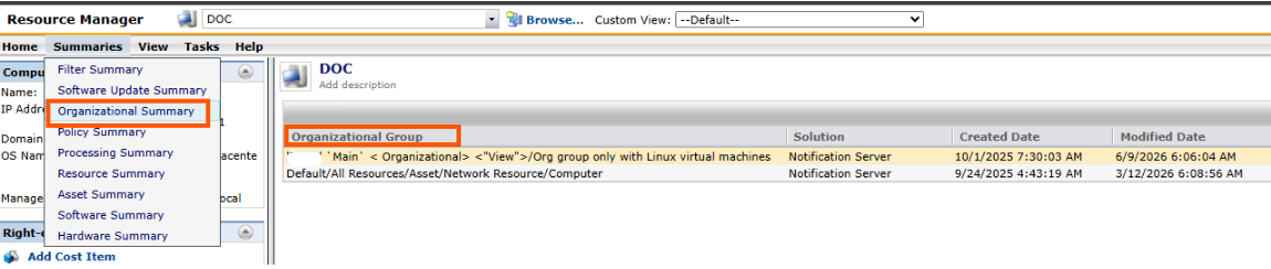

Verify that the affected system appears in the intended exclusion group.
Manage > Organizational ViewsAs well, from Resource Manager you can verify the affected production computer in what Organizational groups it is in and when that organizational group was modified.
The Audit History can help determine when group membership changes occurred.
Manage > Organizational ViewsReview:
