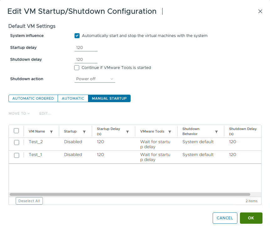

Option 1: Using the vSphere Client (Recommended)
  1. Log into vSphere Client.
  2. Select affected ESXi host in the inventory.
  3. Navigate to the Configure tab.
  4. Under Virtual Machines, select VM Startup/Shutdown.
  5. Click Edit.
  6. Ensure the checkbox "Automatically start and stop the virtual machines with the system" is selected.
  7. Verify that the desired VMs are listed in the "Automatic ordered" or "Automatic" Startup group. (If VMs are not seen in the list, follow the below steps)
    1. Navigate to the manual startup window and select the VMs
    2. Use the "Move to" option to move the VMs to the desired group
  8. Click OK.
