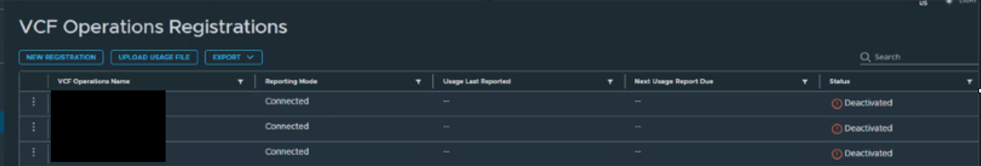

  • VCF Operations instance appears in a Disconnected, Deactivated, or Pending Activation state under the VCF Operations Registrations tab within the VCF Business Console.

  • The VCF Operations instance appears as Deactivated/Pending Activation in the VCF Business Console, and no License Server entries are displayed beneath it:

  • Stale Registration Entries: Multiple ghost registrations of VCF Operations on the VCF Business Console.

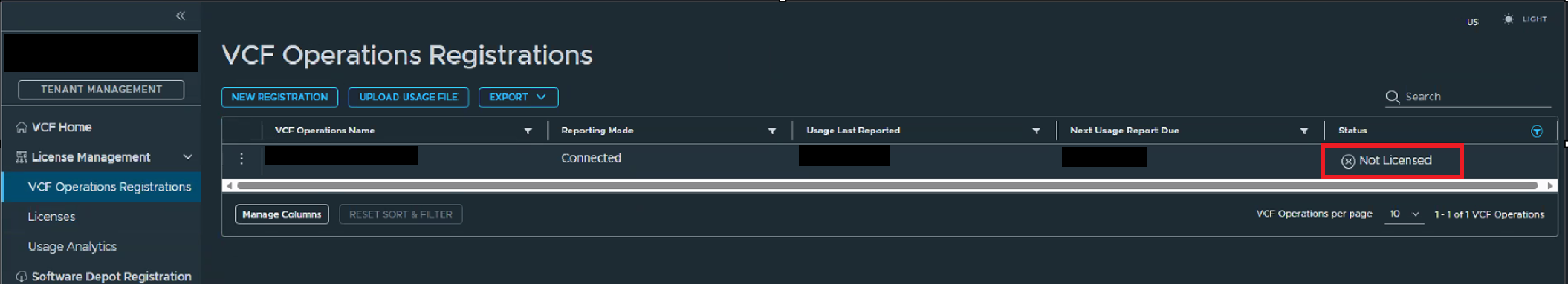

  1. Reregister the VCF Operations to VCF Business Console with the new license server: Since the status of the VCF Operations shows as Disconnected/Pending Activation, it means that the VCF Business Console is still waiting for the activation call from VCF Ops. Follow the instructions from either of the following document as per the connectivity mode to perform a reregistration:
  2. After reregistration, the VCF Operations should appear as Not Connected on VCF Business Console:

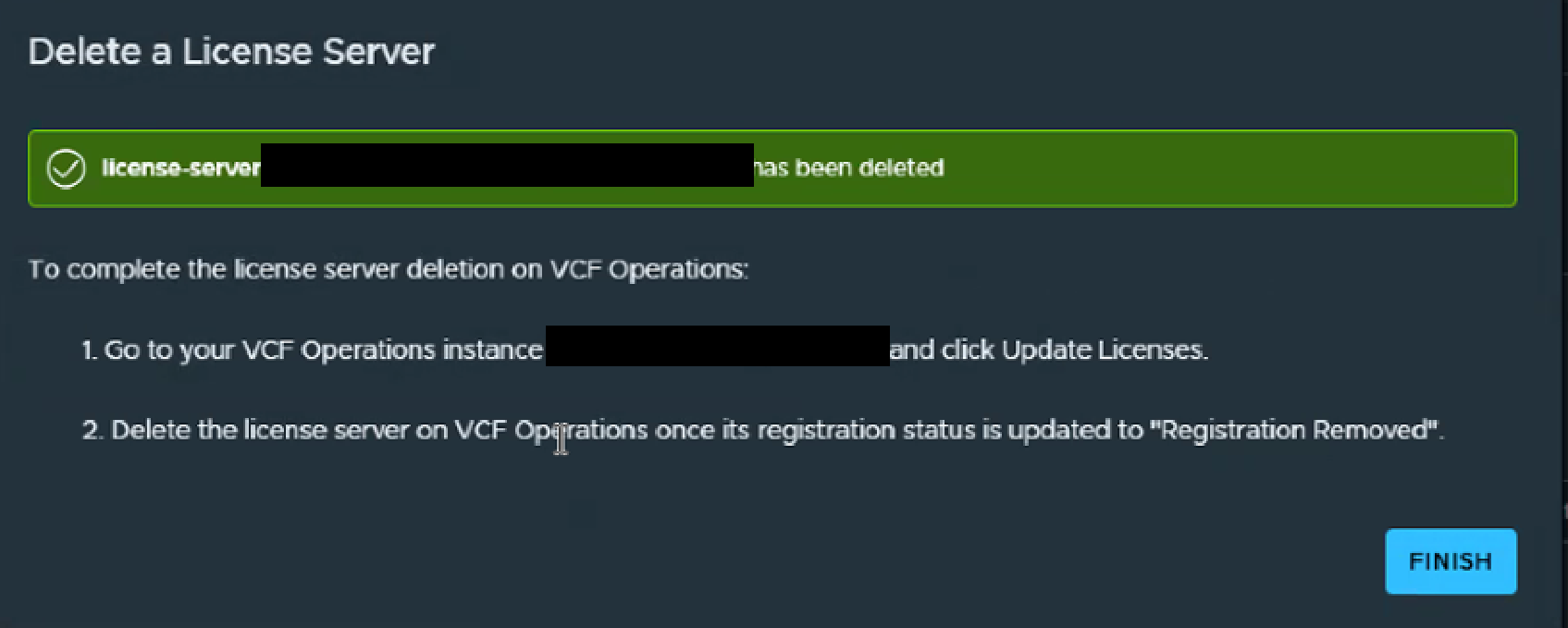

  3. Delete the old License Server from VCF Business Console which was previously deployed and connected to the VCF Operations. Click on License Management > VCF Operations. From the License Server table, click on three dots for the older License Server (which is not existing anymore) and click on Delete.
    Follow the documentation for more reference on how to delete the License Server: Delete a License Server

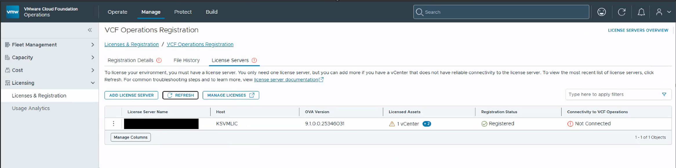

  4. The new License Server should show as Connected to the VCF Operations now. To confirm login to the VCF Operations appliance as admin user, click on Manage > Licensing > Licenses & Registration > Manage > License Servers.
