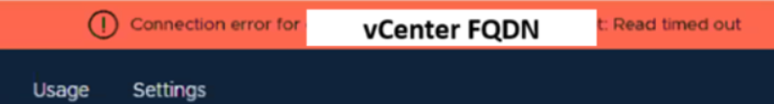

Adding a vCenter Server to Usage Meter fails, and the following error is displayed: Connection error for <vCenter FQDN>: Read timed out
