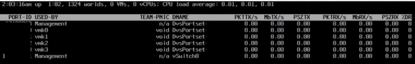

Post upgrade we notice TEAM-PNIC as void, indicating the physical nic not detected:
