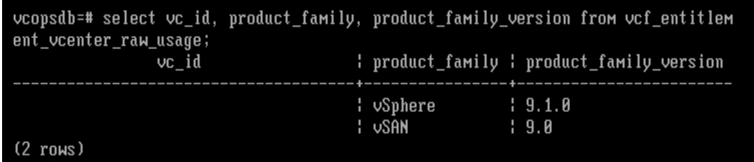

Invalid '9.0' licensed components remain in the VCF Operations database, which conflicts with applying the new 9.1 license to the vCenter Server.
This issue will be fixed in an upcoming version of VCF. To obtain a workaround, please open a SR with Broadcom Technical Support and reference this Knowledge Base article 443974 .
