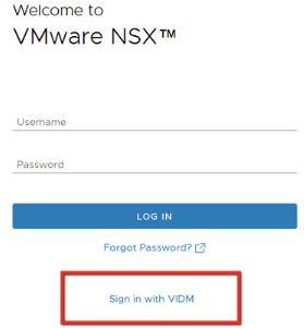

The correct NSX UI authorization workflow to follows is below:
  1. Click the "Sign in with vIDM" link on the NSX UI login page (do not enter credentials into the local login fields):
  2. Log into the vIDM server with a vIDM user account.
  3. vIDM server redirects the browser back to NSX.
