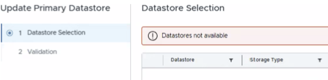

  • Unable to update the primary datastore via the SDDC Manager user interface in a VMware Cloud Foundation (VCF) 9.1 environment. The environment contains a mix of Fibre Channel (FC) and non-FC (local) datastore.
  • During the execution of a datastore query from the SDDC Manager GUI, the operation fails with the error " Datastores not available".

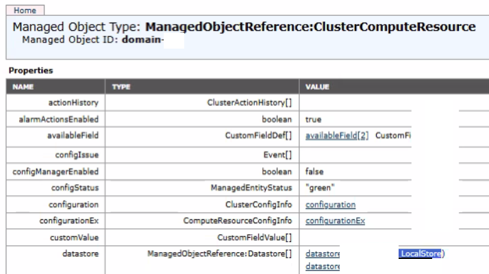

  • While checking the vCenter mob through https://<vcenter_server_IP/fqdn>/mob/?moid=domain-c#, the first datastore in the list is a local datatore.
