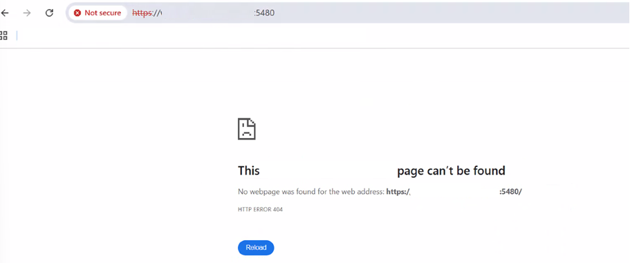

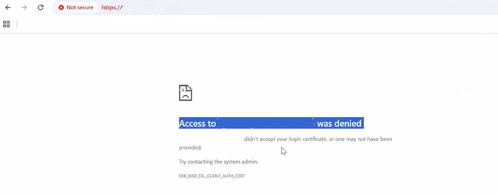

When attempting to access the VAMI via FQDN or IP address, the web page fails to load and throws the following errors:
This <fqdn/IP> page can't be found
Access to <fqdn> was denied
Protection and Recovery 9.1
This issue occurs because the Protection and Recovery Proxy appliance was deployed instead of the primary Protection and Recovery appliance.
