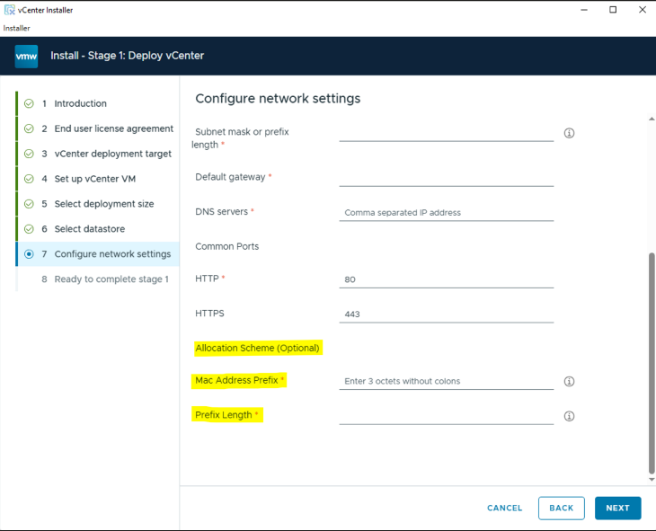

When going through a deployment of a vCenter 9.x in Stage 1 > Step 7 > Configure networking settings > Allocation Scheme (Optional) and values are populated, you may experience vpxd service failing to start during Stage 2
Stage 2 Error: An error occurred while starting service 'vpxd'

This happens when the MAC Address Prefix and Prefix Length are overlapping when manually populated incorrectly in Stage 1 > Step 7 > Configure networking settings > Allocation Scheme (Optional)
1. If you accidently populated the Stage 1 > Step 7 > Configure networking settings > Allocation Scheme (Optional) > MAC Address Prefix and Prefix Length, and Stage 2 deployment is failing, you would need to re-deploy the vCenter and leave those values empty during Stage 1.
2. If you are leveraging this configuration and incorrectly populated the Stage 1 > Step 7 > Configure networking settings > Allocation Scheme (Optional) > MAC Address Prefix and Prefix Length, and Stage 2 deployment is failing due to Error: An error occurred while starting service 'vpxd'
Then the MAC address prefix and length populated were incorrect or overlapping.
