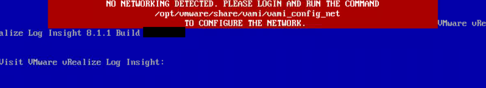

  1. After migrating the VM from the NSX-V environment to NSX-T, a worker node VM in the vRealize Operations for Logs cluster is unable to obtain an IP address during initialization.
  2. Verification through the vCenter Server console shows that no IP address is assigned to the VM's network interface.
    1. From vCenter, the VM web console shows the following message.
    2. When you try to power on the VM from the web console, it fails with a message indicating that the network needs to be configured.
