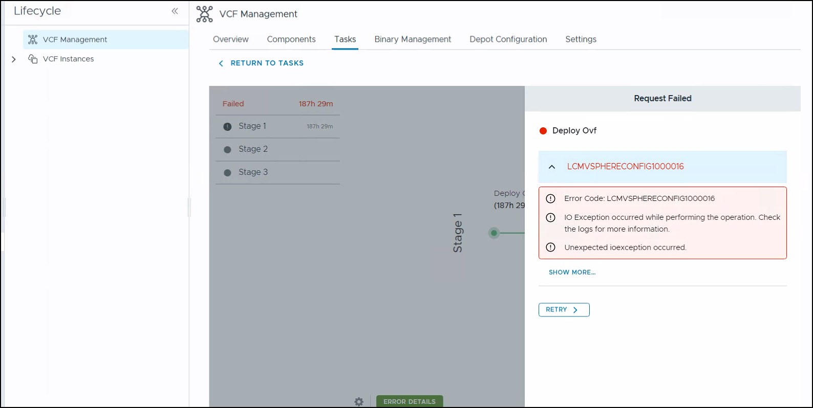

When attempting to deploy a new Cloud Proxy, scale-out an existing deployment, or import a proxy across multiple sites using the VCF Operations Fleet Management Appliance, the task fails during the deployment phase.
The UI displays the following generic error:
Error Code: LCMVSPHERECONFIG1000016
Message: IO Exception occurred while performing the operation. Check the logs for more information.
Details: Unexpected ioexception occurred
