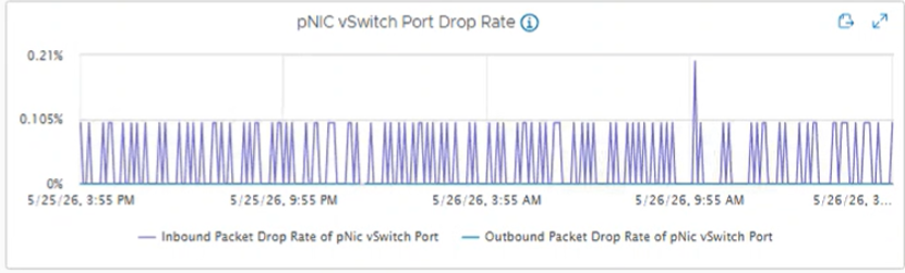

  • vSAN Skyline Health Performance graphs (Monitoring > vSAN > Performance > Physical Adapter) show high pNIC vSwitch Port Drop Rate for some of the hosts.

  • The "pNIC vSwitch Port Drop Rate" indicates that network packets are being discarded at the internal boundary between the hypervisor's virtual switch (vSphere Standard Switch or vSphere Distributed Switch) and the host's physical network adapter (pNIC/vmnic).
  • This typically occurs due to buffer exhaustion during sudden traffic microburst or massive surges of data that occur in fractions of a second.
