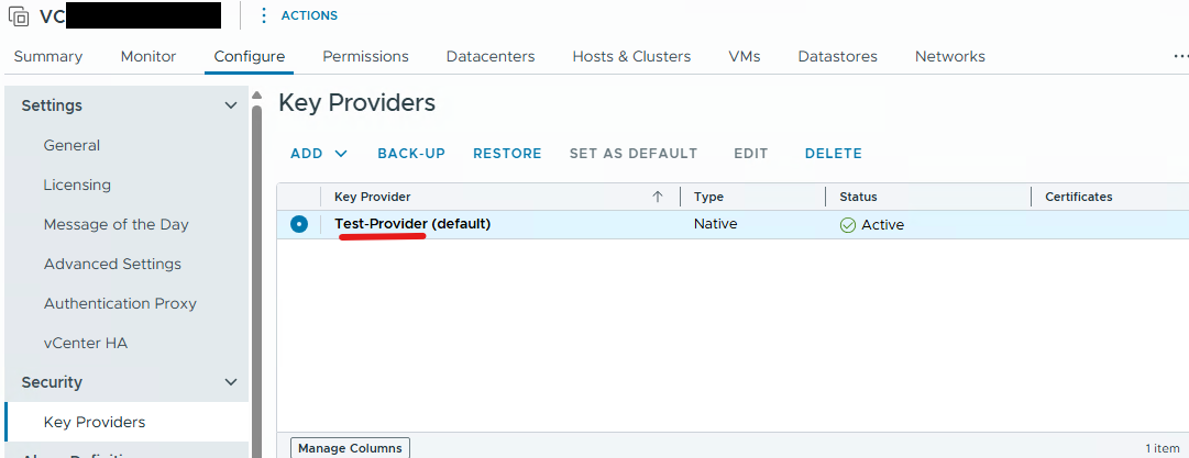

2. Identify the Key Provider name as displayed in the vCenter UI.
  • Login to the vCenter Server UI
  • Select the vCenter Server within the inventory tree
  • Go to Configure > Security > Key Providers.  Locate the target key to be used and record the name as it is seen.

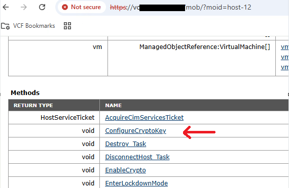

2. Enable the MOB interface for the vCenter Server by following the steps outlined in "The MOB is disabled", unable to access the vCenter MOB in VCF 9.0
3. Login to the mob using the following URL after updating the host ID accordingly: https://<vc-fqdn>/mob/?moid=host-**
  • Using the host ID from the above screenshot:  https://<vc-fqdn>/mob/?moid=host-12
4. Under "Methods", find and select "ConfigureCryptoKey"

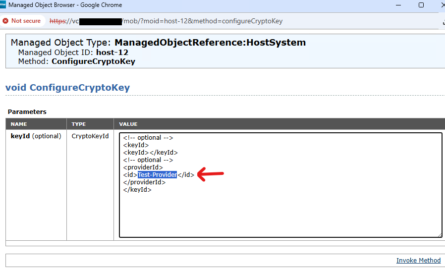

5. In the new window, update the providerid id field to match that of the Key Provider as seen in the vCenter UI.
6. Select "Invoke Method" at the bottom right.  A "Method Invocation Result: void" is expected.
