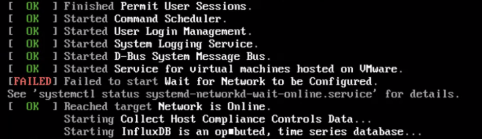

  • Attempting to deploy a License server OVA from vCenter may fail post License server deployment during the License server Network configuration phase with an error similar to below on the License Server VM console:
    [FAILED] Failed to start Wait for Network to be Configured.

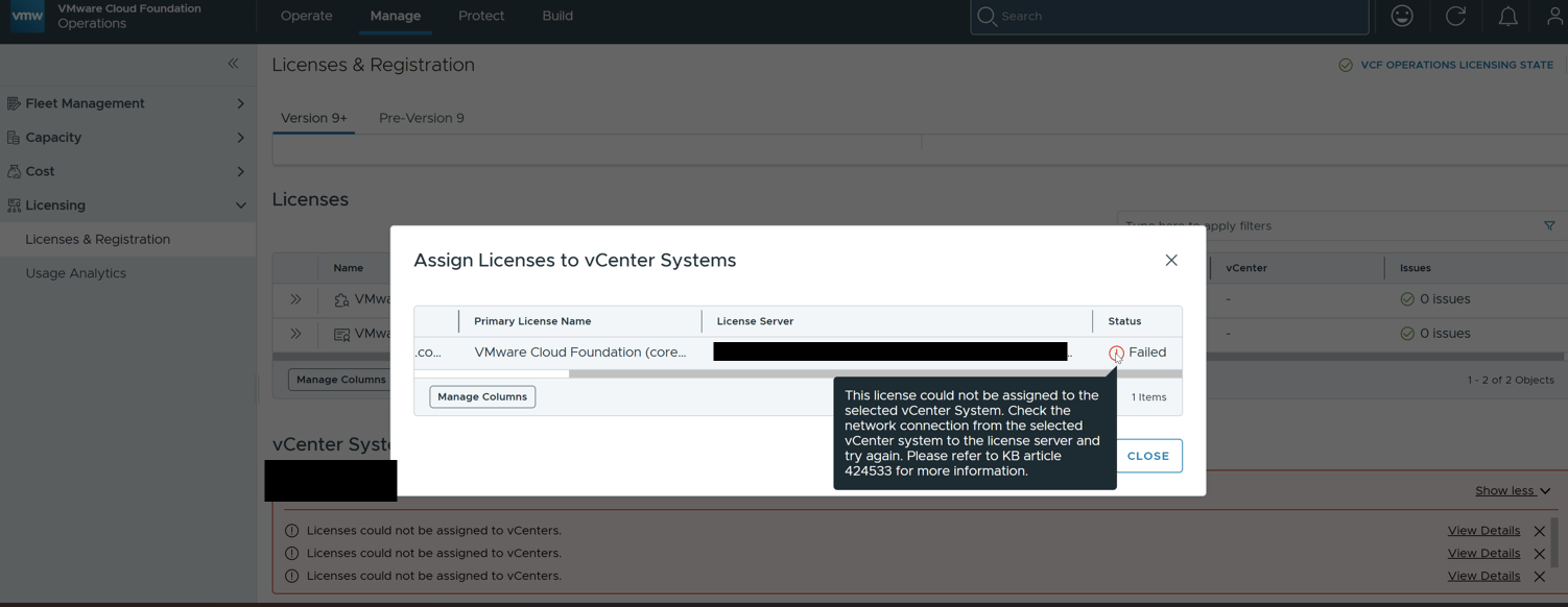

  • In VCF Operations > Manage > Licenses & Registrations tab  > vCenter Systems tab, selecting the View Details button for the error message shows the message below:
    This license could not be assigned to the selected vCenter system. Check the network connection between the license server and the selected vCenter system and try again.
