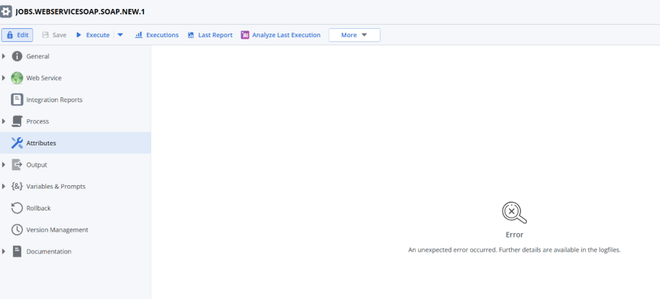

When working with Web Service SOAP jobs in the Automic Web Interface (AWI), an error occurs in the Attributes tab. This NullPointerException (NPE) prevents the tab from loading correctly after modifications are made to the job configuration.
Symptoms
  • The Attributes tab fails to load and displays an error message:
  • The AWI log files contain the following error:
    [ERROR] AESYSTEM:CLIENT/USERNAME/DEPARTMENT +RNDR [com.uc4.ecc.plugins.objecteditor.impl.views.UC4ObjectViewLayout] - Error opening Sheet com.uc4.ecc.plugins.objecteditor.impl.sheets.ObjectEditorPanelSheetContainer@xy java.lang.NullPointerException: Cannot invoke "com.automic.ecc.ae.sheet.ra.soap.job.general.GeneralPanel.getConnection()" because the return value of "com.automic.ecc.ae.sheet.ra.soap.job.RAJobObjectSheetView.getGeneralPanel()" is null at com.automic.ecc.ae.sheet.ra.soap.job.RAJobObjectSheetPresenter.attributeAgentChanged(RAJobObjectSheetPresenter.java:93)
  • The issue is consistently reproducible after changing the Agent on a SOAP job, saving, and then reopening the job attributes.
