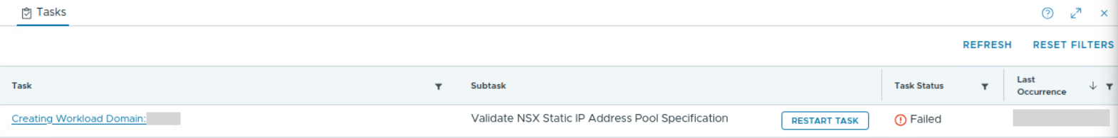

/var/log/vmware/vcf/domainmanager/domainmanager.log:<Timestamp> ERROR [vcf_dm,<Id>,<Id>] [c.v.e.s.o.model.error.ErrorFactory,dm-exec-12] [F6UAAI] PUBLIC_IP_ADDRESS_POOL_SPEC_VALIDATION_FAILED IP address pool spec validation failed with errors [The gateway IP address in the spec <Gateway_IP> is not part of the subnet <Subnet>]
com.vmware.evo.sddc.orchestrator.exceptions.OrchTaskException: IP address pool spec validation failed with errors [The gateway IP address in the spec <Gateway_IP> is not part of the subnet <Subnet>]

The validation fails because the Gateway IP entered for the NSX TEP subnet during the Workload Domain creation is not included within the specified subnet.
Enter the correct Gateway IP and retry the Workload Domain creation.
