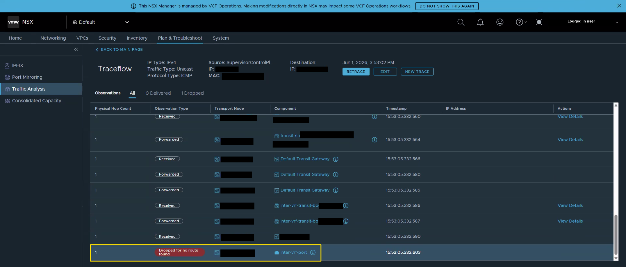

The NSX environment is missing a required route. Because the Virtual Routing and Forwarding (VRF) instance does not have a defined path for this outbound traffic, it drops the packets directed toward the public repository. An NSX traceflow confirms the packet is "Dropped for no route found" on the inter-vrf-port.
To resolve this issue, you must configure a static or dynamic route in NSX to allow north/south traffic to traverse properly:
  1. Identify the required network path for your outbound external repository traffic.
  2. Create a static or dynamic route within NSX to provide the VRF with a defined path to external addresses.
  3. Re-run an NSX packet traceflow or a command-line curl test to verify that the traffic successfully traverses the inter-vrf-port.
