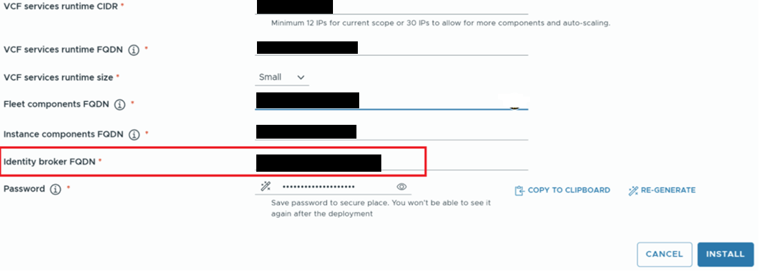

  • The Identity Broker deployment requires an unique FQDN and a fresh IP address. If the FQDN provided in the wizard resolves to an existing IP (such as the vCenter FQDN), the Fleet Lifecycle manager fails validation.
  1. In order to resolve the issue, the existing configuration has to be re-initiated post updating the FQDN for VIDB (Identity Broker)
