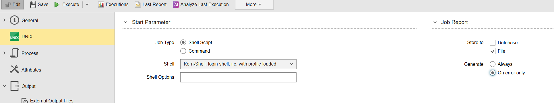

On the Unix Jobs that run around the time of the issue, change the following:
Section UNIX - Job Report - change "Store to Database" to "Store to File" (and if not needed the reports in case jobs run ok change from "Generate Always" to "Generate On error only" as displayed below
