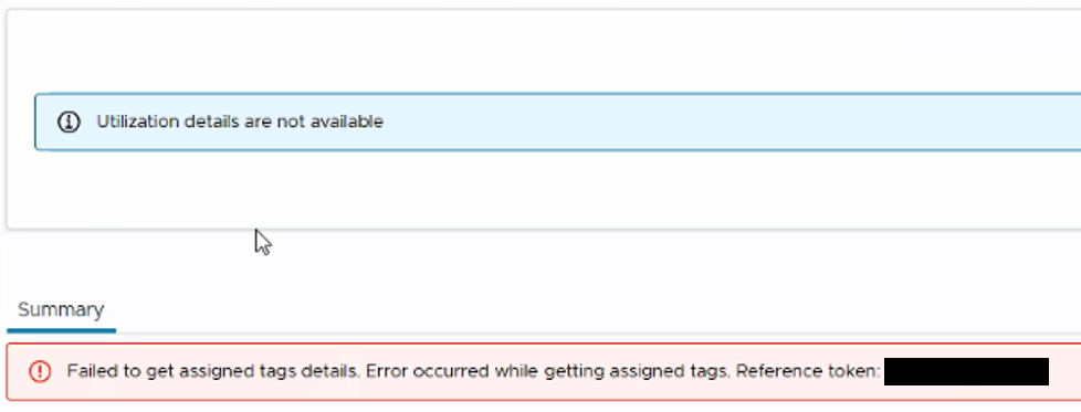

Failed to get assigned tags details. Error occurred while getting assigned tags
When attempting to review ESX host details in the SDDC UI, the utilization details may not be available and an error may be presented in the summary - Failed to get assigned tags details. Error occurred while getting assigned tags.

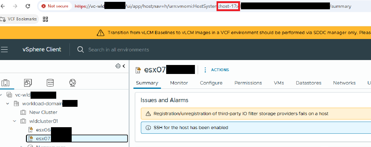

Reviewing the ESX host from managing vCenter Server UI may show that the host has a different ID:
In the above, the host has a source_id of "host-17" in the vCenter Server managing it
