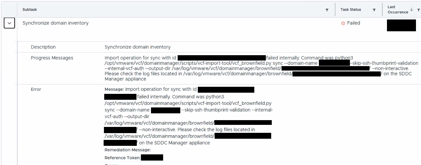

Under SDDC's /var/log/vmware/vcf/domainmanager/brownfield/UUID/output/guardrails_report_.csv, below error logs are found:
[YYYY-MM-DDTHH:MM:SS] [INFO] check domain: 270: [93mFor more details, please, check:[00m [93m Failed guardrails YML:[00m/var/log/vmware/vcf/domainmanager/brownfield/#####-####-####-####-#####/output/guardrails_report_<VCENTER-FQDN>.yml Failed guardrails CSV:[00m/var/log/vmware/vcf/domainmanager/brownfield/#####-####-####-####-#####/output/guardrails_report_<VCENTER-FQDN>.csv All guardrails CSV:[00m/var/log/vmware/vcf/domainmanager/brownfield/#####-####-####-####-#####/output/guardrails_report_<VCENTER-FQDN>_all.csv[YYYY-MM-DDTHH:MM:SS] [CRITICAL] vcf brownfield:1007:ESC [91mFailed to sync domain <MGTDOMAIN>Traceback (most recent call last): File "/opt/vmware/vcf/domainmanager/scripts/vcf-import-tool/vcf brownfield.py", line 984, in sync domain sync_domain result: list [str]=sync. sync_domain () File "/opt/vmware/vcf/domainmanager/scripts/vcf-import-tool/domain_sync/sync_domain.py", line 114, in raise DomainSyncException (ErrorMessages.GUARDRAILS SYNC FAILURE_CRITICAL FOR_DOMAIN.format (domain_id) )common.common_exceptions.DomainSyncException: Could not proceed with sync operation since domain with Id: #####-####-####-####-##### has failed guard rails. This would leave SDDC Manager in a unconforming state Retry the sync operation after fixing guard rails warnings.
Under SDDC Manager's /var/log/vmware/vcf/domainmanager/domainmanager.log, below error log snips are found:
YYYY-MM-DDTHH:MM:SS ERROR [vcf dm, ##########, ####] [c.v.e.s.o.model.error.ErrorFactory, dm-exec-##] [######] ERROR_IN_VLAN_BACKED_TNC_CONFIG_GENERIC Error in configuring VLAN backed transport node collectionscom.vmware.evo.sddc.orchestrator.exceptions.OrchTaskException: Error in configuring VLAN backed transport node collections at com. vmware . vcf . common . fsm.plugins .nsxt . policy. action.CreateVlanBackedTransportNodeCollectionAction. execute (CreateVlanBackedTransportNodeCollectionAction. java : 273) at com. vmware. evo. sddc. orchestrator.platform. action. FsmActionState. invoke (FsmActionState. java: 66) at com. vmware. evo. sddc. orchestrator.platform. action. FsmActionPlugin. invoke (FsmActionPlugin. java: 161)Caused by: java.util.concurrent.CompletionException: com.vmware.evo.sddc.orchestrator.exceptions.OrchTaskException: Error in configuring VLAN backed transport node collections for clusters <STANDALONEHOST-FQDN> at java.base/java. util. concurrent. CompletableFuture . encodeThrowable (CompletableFuture. java : 315) at java.base/java. util. concurrent. CompletableFuture$AsyncSupply . run (CompletableFuture. java : 1770) .. 4 common frames omittedThe failure is due to strict infrastructure validation (guardrails) requiring a cluster context (minimum 3 hosts) for NSX configuration.

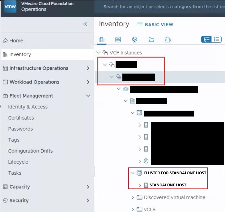

Log in to the vCenter Server UI where the Standalone Host resides using, SSO Credentials.
Navigate to the Cluster in which the Standalone Host is present.
Drag and Drop on to the Datacenter within the same vCenter (this will move the Host out of the Cluster).
Return to the VCF Ops Manager UI.
Rerun the Sync Inventory task.
