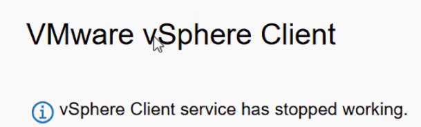

  • The vsphere-ui service fails to start on the vCenter Server Appliance. The service initialization aborts almost immediately during startup, causing the vSphere Client to be inaccessible.
  • The vSphere Web Client login page will display the error: 'vSphere Client service has stopped working.
  • The vCenter Server certificate renewal process may fail during the service startup phase.
